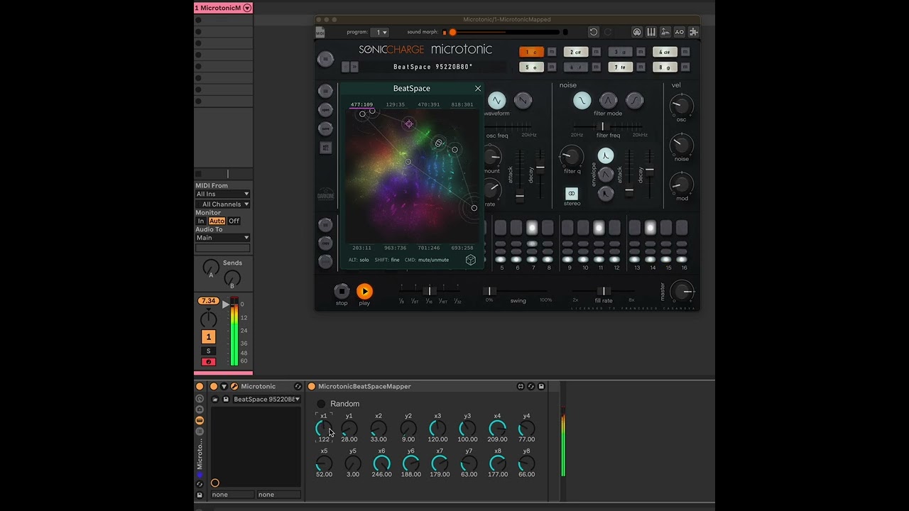

    Hello everyone!
    Francesco aka Cippo from Italy
    I really enjoyed the BeatSpace feature of Microtonic and I felt a bit disappointed that was not mappable in MIDI or whatever. So i tried to "hack it" I hope Magnus will not be angry with it.
    The principle is simple, i modified the BeatSpace_main.js file that you can find in ~/Library/Application Support/Sonic Charge/Microtonic Scripts/BeatSpace.mtscript/ adding the feature that is continuosly reading a .JSON file every 30msec where inside there is the array with all the X and Y coordinate of every point.
    Then i created a MaxForLive that is writing continuosly that specific file in realtime, using live object in Max you will be able to map every single parameter with Automation or LFO.
    BUT
    There is a huge limitation, all this things works if the interface of Microtonic it's open and the BeatSpace interface is open.
    Not a special thing but i think it's funny to try out with it.
    Now it's working just on Mac because is the only system that i have but i will be open to some further updates for Windows if someone can contribute with it :)
    I attached the two files, the modified script and the MaxForLive
    Tested with Max 8.5, Max 9.0, Ableton 11, Ableton 12
    YouTube Video

    Problem: I dropped your script into the Microtonic folder, added the .amxd device to the track with Microtonic, but nothing happens. Do I need to connect them somehow? I’m using Ableton 12.2.
  • Francesco Casanova
    I've spoken with Aleksei, his problem was that was missing the file latentPoints.json inside ~/Library/Application Support/Sonic Charge/Microtonic Scripts/BeatSpace.mtscript/ so i've send him this file and now is working!
    This is the file to download https://drive.google.com/file/d/1Vc68y80wri1IaaCmiHDInsOJKnGatBlu/view?usp=sharing
